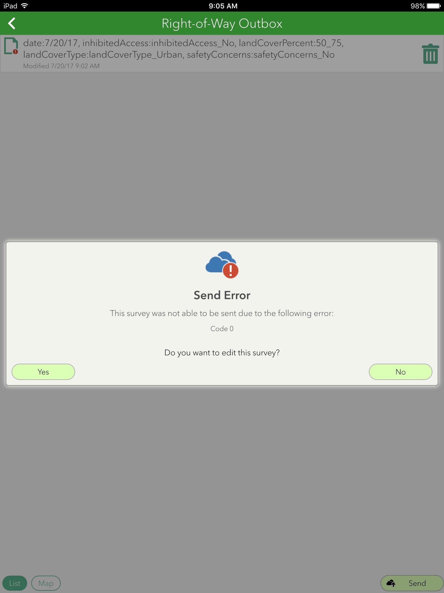

When trying to send a survey after completion, I get an error message saying "This survey was not able to be sent due to the following error: Code 0
We are running on ArcGIS Portal here at Arkansas Electric Cooperatives. We have this going through a hosting server. Any ideas on what could be the problem?

The error code you see is very generic.  Has this form successfully sent survey information before, on this or another device?  The wifi network the iPad is connected to is on the same network as the Portal?

I am not sure how to link you the log file for this. So basically this used to work. Until we got a hosting server as well as an external portal (meaning our organization can access the portal content without being logged on to enterprise internet). I cannot connect to where our main internal portal is. I can only connect to outside portal. Which is strange. Also, I just noticed that on my phone connected to LTE, and I connect to the portal and survey and answer the questions and submit, it doesn't work. However, when I switch to wifi after it fails to send over cellular, and try again it works. It is strange why it it works on the same wifi on my phone and not the iPad. Also, I can't connect to the portal on my phone over wifi in the beginning to set up a portal. Is there a way we can talk on the phone or something?

Yes, like James said, our problem was due to a configuration and/or network issue. We have a distributed ArcGIS Enterprise system comprised of 7 servers all doing different things. And I also believe we had a firewall blocking something.
Also, another issue that we had either with this case or one shortly after was due to updates. Please make sure that you are updated to the latest version of Survey 123 Connect and also the iPhone and Android devices as well.
AdamDaily
It sounds like the version of connect I use to create and publish from in desktop determines which versions of the app on end user devices are able to publish completed surveys.  I first tried to delete just the survey form from my surveys folder and then reload it, but that did not work. I actually had to delete survey off of the J7s and then reinstall the newest version of the app. That did work and I'm glad this was not a network issue, but this solution leads to other concerns. It took me some time testing devices and searching for answers to figure out this error. Our end users will not be aware of, have time for, or care to deal with these types of issues. They will simply see an app that does not work.
My concern is I never saw any indication when opening the app or conducting a survey that my version was out of date. I can't ensure the app is being updated on all of our end user mobile devices. Everything from a user standpoint seemed to work up until trying to submit a completed survey. The error code 0 we are discussing does not mention the app version as a possible problem or recommend updates if available as a solution. I'm not sure the best way to avoid this problem from happening. Stop updating connect?
