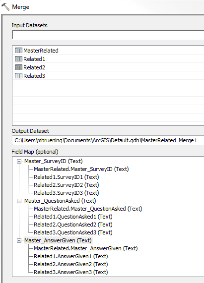

This might...no it will sound absurd, but could you do some post-processing of the data? Just thinking way outside of the box here, but could you essentially modify the Survey to contain a bunch of hidden related tables. Plus create a tool that would allow you to point it at a FGDB of your dataset and process the related tables to end up with your one large table? I think that you would need to figure out some sort of Survey ID also; as this would allow you to query out the responses per survey submitted; since you have questions that can be skipped.
I am unsure if there is a limit on the number of related tables, but if you made a related table that contained data fields named "Survey ID", "Question Asked", and "Answer Given". The "Survey ID" field would be some sort of Id that you generate at the beginning of the survey, "Question Asked" field would contain a default value that matched the question being asked, and then the "Answer Given" field would contain the answer to the question being asked.
Now you would have to increment the name of each related table's question and answer field in order to have unique field names; i.e. Question2, Answer2, Question3, Answer3...all the way to your last QuestionX, AnswerX.
Next you would have to create a master template table named Final_Question_Answers_Table that contains a schema of three text fields; "Master_Survey ID", "Master_Question Asked", and "Master_Answer Given" that would data entered into the related table data fields.
Next you could build a Model builder or python script that will take your Master Template Table and merge all of the related table records into that table; via field mapping portion of the tool, to create the table you are looking for. You would have to point each of the data fields into the corresponding Master data fields' please see screen shot below.
Essentially, the survey is filled out and submitted, then you would have to download the data, after downloading the data, you could point the tool to the FGDB, allow it to process your data, and end up with the table that you want.
