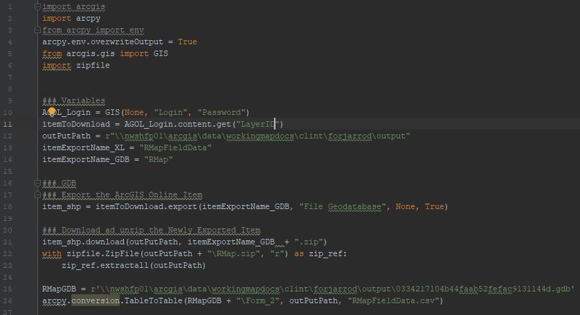

I am trying to write a script that will automate exporting the attribute data in the survey 123 hosted feature layer from AGOL to an excel file.  As I understand it I need to do this from within the ArcGIS Pro environment as I want the columns to be named with the name value from the survey 123 connect XLS form as opposed to the label.  I would also like this script to be able to be run on a schedule as it is written without needing to update information before every run.  Every time a new record is collected however the name of the .gdb file that is extracted from the zipfile changes and new records are not captured in the excel table.  Additionally, the script still requires me to manually delete the excel/csv file each time to rerun the script...  It won't overwrite despite the overwriteoutput = True statement.  Is there a better workflow to download attribute data to an excel file with Python from within the ArcGIS Pro environment?  Any help appreciated, Thanks

Thanks for the reply.  If I run this tool on the feature class in my downloaded database I will still have the problem of my database name changing every time a new record is submitted and the script will point to the old geodatabase not capturing new records.  Is there a way to run this tool and point to a AGOL hosted feature layer as the the input?

Hey Doug and Mic,
Thanks for the help.  I ended up pointing the Table to Excel tool to the hosted feature layer in AGOL and it spit out the table formatted how I wanted it with the names instead of the labels.  I don't work in AGOL very much so I didn't know how to point the tool to the hosted feature layer which is why I started down the other path but this seems much more straight forward. Thanks again!
