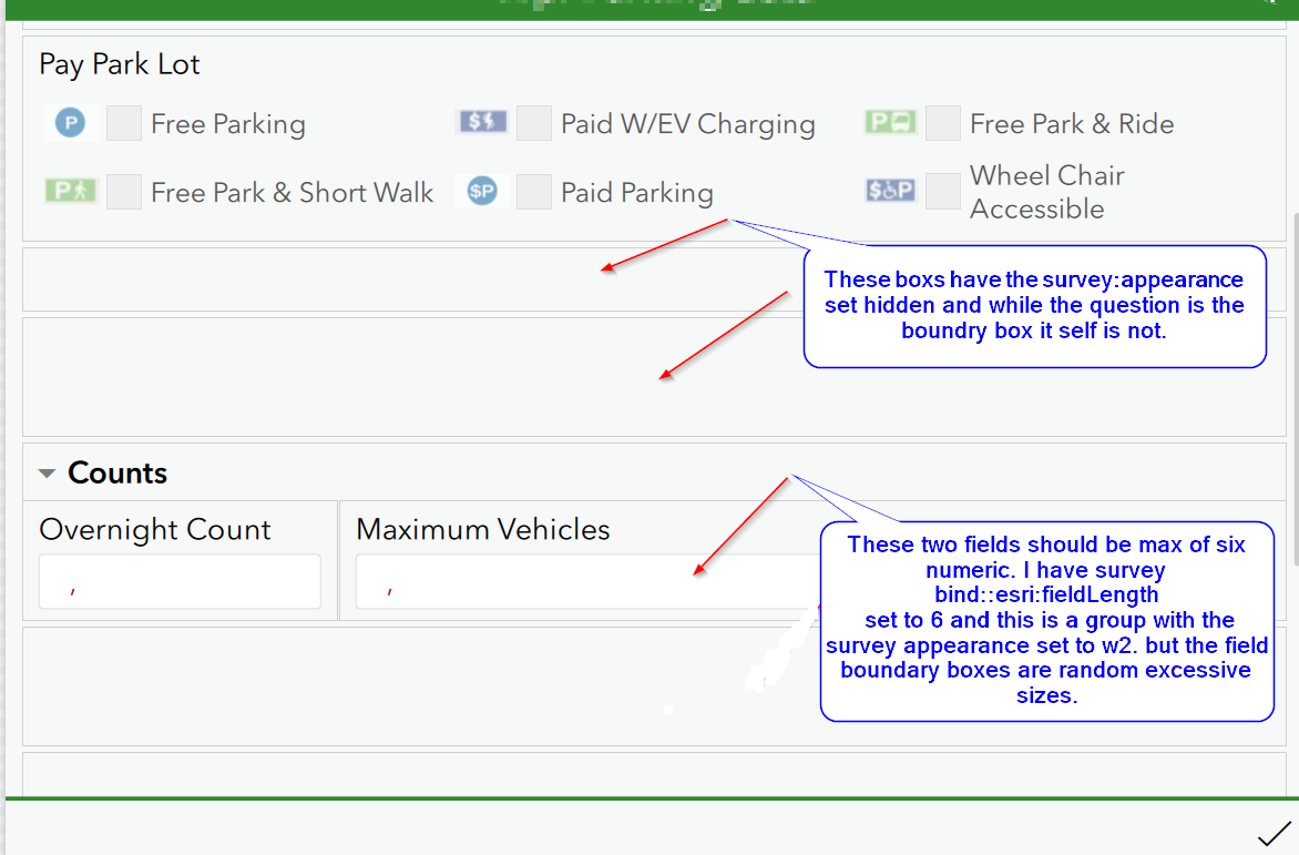

So I am new to Survey 123 Connect.  So some of this may be that I am just missing concepts.
The goal of this survey is to allow staff to make updates only to an existing feature layer that was created by loading a csv and publishing it.   The ability to limit it to update only so far has escaped me and since my layer (table) has a compound primary key I have not yet got the pulldata() to work.
But just building the form has me stumped in two areas;
  1. When I set survey:appearance: Hidden the row is hidden but the form still shows the bounding boxes ?
  2. I have to collect to numeric values that are a max of six whole digits.  I put the two fields between a begin and end group type.  An the Group itself seems to have a name on the form ad is  collapsible even though it is really the only mandatory part of the form, in fact these two fields are the whole point of the form.  Additionally, the bounding boxes are random sizes that do not seem to have anything to do with the survey:bind:esri: fieldlength value.
Appreciate any advice I can get as a newbie to Survey 123 Connect I could use a few pointers beyond the class I took.

For problem 1: It looks like you might have dynamic-grid selected in the style column of your XLSForm settings sheet. This grid style adds placeholder boxes in the survey even if the question is hidden. If you change to fixed-grid or leave the style column empty it removes the extra boxes. I've run into this as well. Hope it helps.
JeffSilberberg
So with some help from support, I have made progress.   @AnnaMiera turns out the issue was a Capital W2 instead of a lower case w2.
