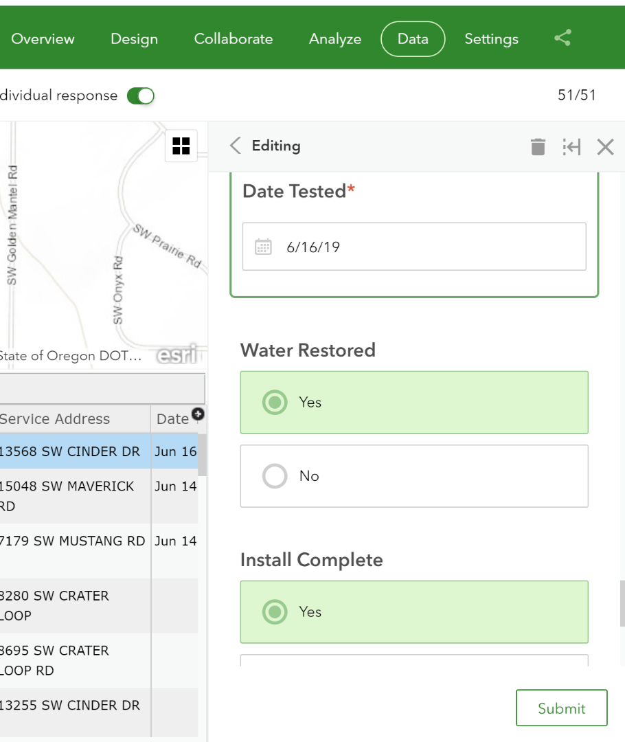

I have set up a webhook with integramat.  I can't get the webhook to trigger when I submit the survey on my mobile device for on the survey123 app on windows.  If I am on the survey123 website, select the survey, click on data, select a survey, click edit the individual survey and submit.  The webhook works great.  See below.
I want my guys to submit a survey in the field and have the webhook run when the do that.
Any suggestions?
