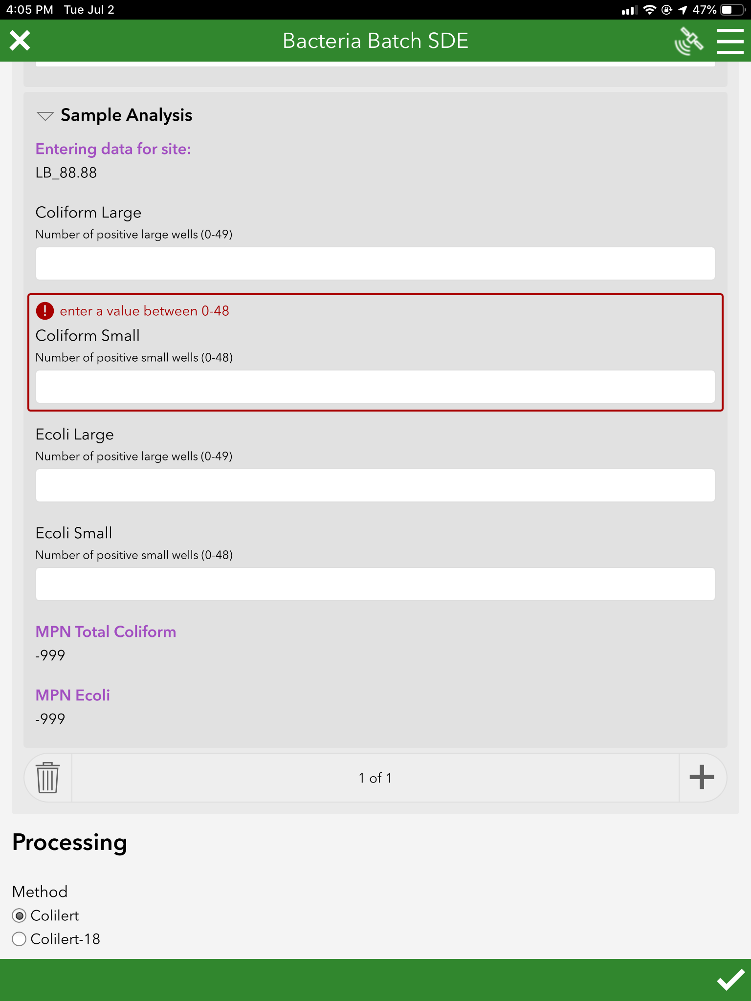

Our Bacteria Batch SDE field form includes a repeat for stream water samples collected, with two groups within the repeat: "Sample Collection", and "Sample Analysis".  On day 1, we collect multiple samples and enter them in the "Sample Collection" group.  On day 2, we open the "Sample Analysis" group and toggle through the collected samples to enter additional data (post 24-hour incubation to see what grew overnight).  This functionality is no longer working. And it's failing in a really strange way.
Now, when we click the "+" to enter the next sample, it pops open the Sample Analysis group (overriding the "compact" appearance setting for the group) -AND- gets hung up on the constraint for the second question in the group (see screenshot). It even displays the constraint message, so it's acting like we've tried to send the survey.
It will not let us enter more than one sample without first entering the analysis data, which we won't have until the following day. Luckily we have two other ipads that are running v3.3.64!

Hi Lynn,
You can't check for NaN directly; you should use the comparison
string-length(.) = 0
as the check for null/NaN. Additionally, you could use or in the check instead of an if:
string-length(.) = 0 or (. >= 0 and . <= 49)

I think this is actually now correct in 3.5.  You should NOT be able to move to the next repeat until ALL constraints are satisfied.  The old way it was letting you skip and move on - which was bad for me.  In fact I had to create workarounds to make sure it did stop from adding a repeat.
Does this sound like it?
This sounds like another care of letting us control when validation happen through settings.

Oh rats. If that's true, then we're going to need to rethink (rebuild) this survey. Ugh.  As described, we move through the repeat to enter multiple records, then revisit those records the following day.  And I cannot remove those constraints. Double ugh.

if I remember right I got around this by using an if in your constraint. So say if value1 is not blank then check constraint otherwise do nothing.

Constraints:
ColiformLarge:   . >= 0 and . <= 49
ColiformSmall:   . >= 0 and . <= 48
EcoliLarge:    . >= 0 and . <= 49
EcoliSmall:    . >= 0 and . <= 48
Although I'm not entirely sure how to achieve your suggested:  "if value1 is not blank then check constraint otherwise do nothing".
I tried the following, but they didn't work:
if(${ColiformLarge} != '', (. >= 0 and . <= 49),'')
if(${ColiformSmall} != '', (. >= 0 and . <= 48),'')
if(${EcoliLarge} != '', (. >= 0 and . <= 49),'')
if(${EcoliSmall} != '', (. >= 0 and . <= 48),'')
Also, it's strange how the form got hung up on the second field with a constraint. Why not the first?  Or all four?

Sorry I should have included that.  I figured it would come up.
You want it to evaluate to true so I just use 1.
So if(check, constraint, 1)

Thanks Doug. Okay,  I made a couple other changes (using NaN since this is an integer field):
if(. != NaN, (. >= 0 and . <= 49), 1)
Didn't work.
James Tedrick‌ is there something I'm missing?

Hi Lynn,
