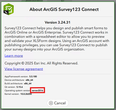

Hi James,
We get "SSL handshake failed (6)" error in Survey123 Connect after upgrading ArcGIS Enterprise 11.3 to 11.5. Survey123 Connect versions tried: v3.17, v3.21 and v3.24. Some notes:
  • This Portal is not public facing
  • We have tried to connect with Survey123 Connect and Survey123 mobile app this both at home and office
  • Connections to other Portals (that are still 11.3) work fine at home and at office
  • We did not encounter this issue when upgrading from 11.1 to 11.3
What have been done:
1. In Portal:
  • Validity of certificates checked
  • Certificate checked and re-imported
  • TLS setting and cypher suites checked and adjusted
  • Checked loggings at multiple levels in Portal
  • Compared to other Portal environments (that are still v11.3) and settings
  • Compability check:  Survey123 Connect v3.20 and above is compatibel met Enterprise 11.x, including 11.5
2. In Survey123 Connect:
Thanks in advance!
