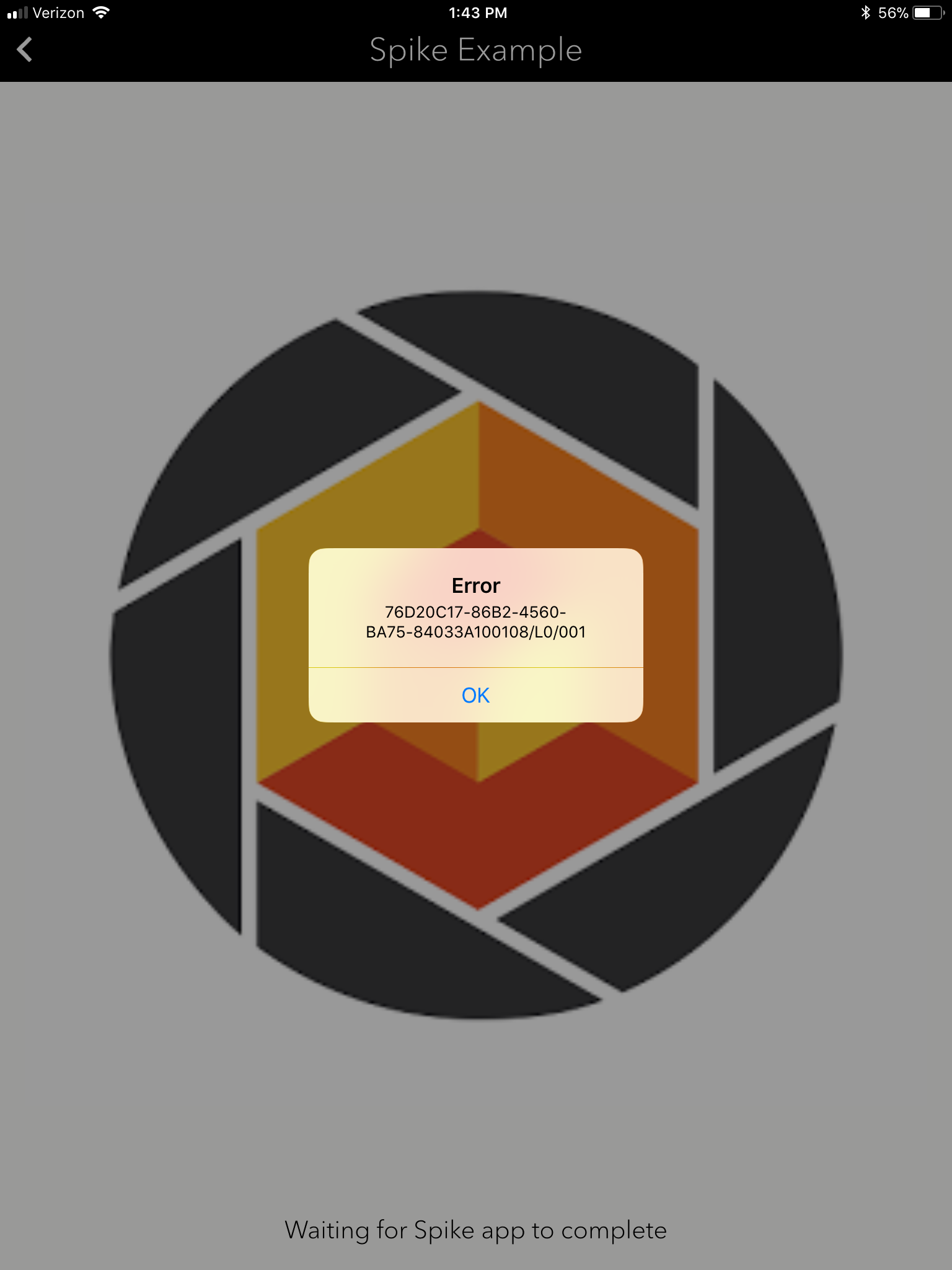

I am testing Spike integration with Survey123 and the data is not being passed into the form. I've tried the sample Spike form, and a custom single question form, and both result in the same problem. The error code changes but is a similar every time:
Some additional info:
Survey123 version 2.7.98, Connect version 2.6.6, brand new spike for tablets and an iPad Mini 4 Cellular+Wifi.
Any ideas why this isn't working?

Hi Ryan
There are a couple of issues here:
1) To ensure that Spike integration works as intended on iOS, some system permissions need to be set.
  • Both Survey123 and Spike need to have access to the camera.
  • Both Survey123 and Spike need to have both read and write access to photos.
  • In photo settings, the iCloud photo library should be disabled.
2) You need to use the spike-full-measure appearance to do length measurements (not spike).
Thanks
John

RyanGatchell1
Thanks John! It was the iCloud photo library.
Very much appreciated,
