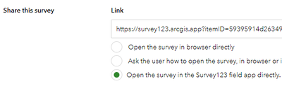

Anyone else encountering issues with the sharing URL for opening the survey in the Survey123 field app directly?
The generated URL is, e.g.:
   https://survey123.arcgis.app?itemID=59395914d2634916878bdb7430b01536
or
   https://survey123.arcgis.com/share/59395914d2634916878bdb7430b01536?open=native
both of which get redirected to (note slash added, but otherwise same as first link):
   https://survey123.arcgis.app/?itemID=59395914d2634916878bdb7430b01536

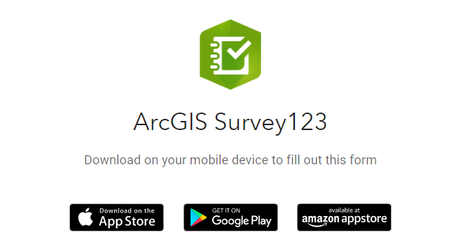

and that asks the user to download the app even if it's already downloaded, with no option to bypass.
I'm getting this for multiple public survey forms on multiple devices. iOS seems immune, but Android and Windows are not.

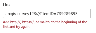

Yes, this does still work if you create it manually. The issue is how you are delivering links to users. I have links stored in SharePoint and in custom QR codes. In both cases, Esri's custom URI (arcgis-surveys123) is not recognized by the applications. If it doesn't start with HTTP/HTTPS, then it isn't considered a link and thus won't work:
Because this is an important point, I will drop this in the other thread as well.

To wrap this up, the links to share a survey, as derived from the Survey123 website, may not work; e.g.
Additionally, the link from "Ask the user how..." will not work if the user selects "Open in the Field App." This is a serious bug, slated for enhancement from the Survey123 side of things, reportedly ENH-000151516.
