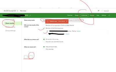

HariharNepal
hello FasilTiru, I tried to share results using collaborate tab, it does not work. There i no "share survey result" link available, and when I click on "save" button, it gives me error "failed to save", the error message is something like
....._results' already exists...
..."tokenExpires":...
can you help me?
