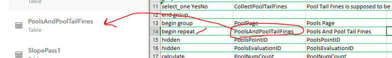

Here's some screenshots of what I've got, the feature class and table names in the database have no spaces, but the aliases do. When I publish to AGOL as a feature service the feature layers and tables all come in with the alias as the name, spaces and all. I opened the REST for the field conversations and the hosted table name has a space in it.

I think it is just showing you the alias.  The real name probably has no spaces.  Scroll down the rest page and hopefully you will see it.  In theory it would match the names as you published them.  I have not really seen this before but I tend to have the alias the same.  123 but be grabbing the wrong name.  Convert those to the way you published them with the underscore and see if that does it.
