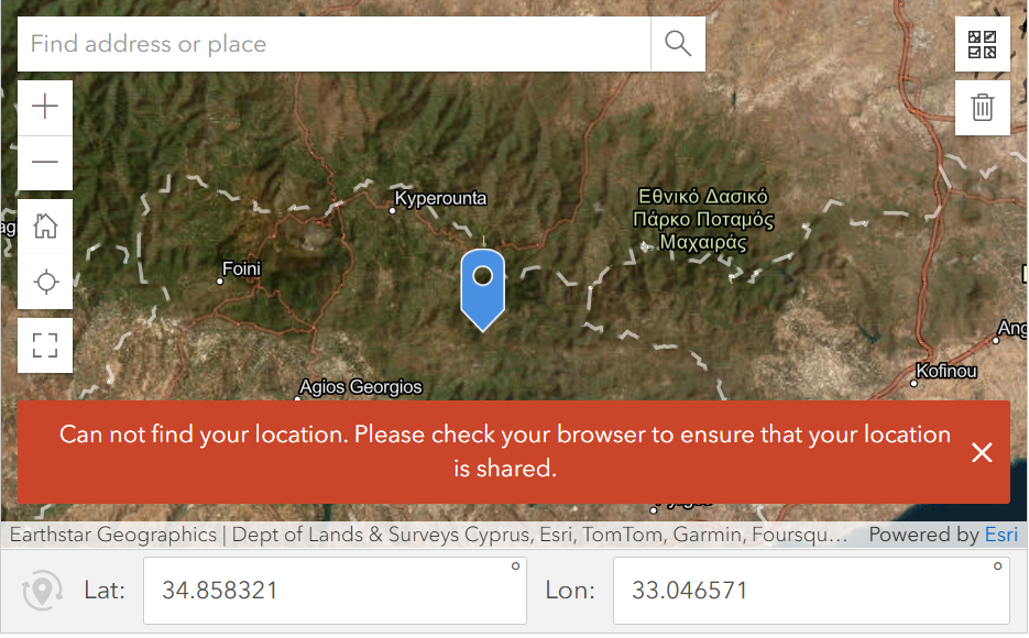

Hi, is there a way for the webform to default the coordinates format to UTM?
I want my users to enter UTM coordinates without having to select the UTM format so as to change it from Decimal Degrees.
The coresponding setting in Survey123 connect doesn't affect the webform.
Thanks in advance.
