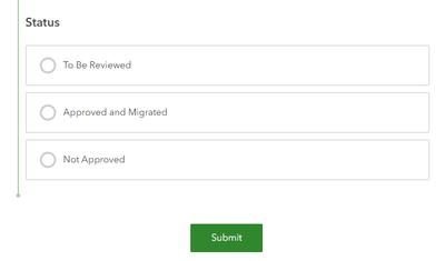

In design mode, I tried clicking the radio button beside a choice:
But in preview mode, the choice did not get automatically selected.
If clicking the radio button in design mode doesn't set a default value, then what does it do?

I tried saving and previewing, but no luck. The form isn't published yet.

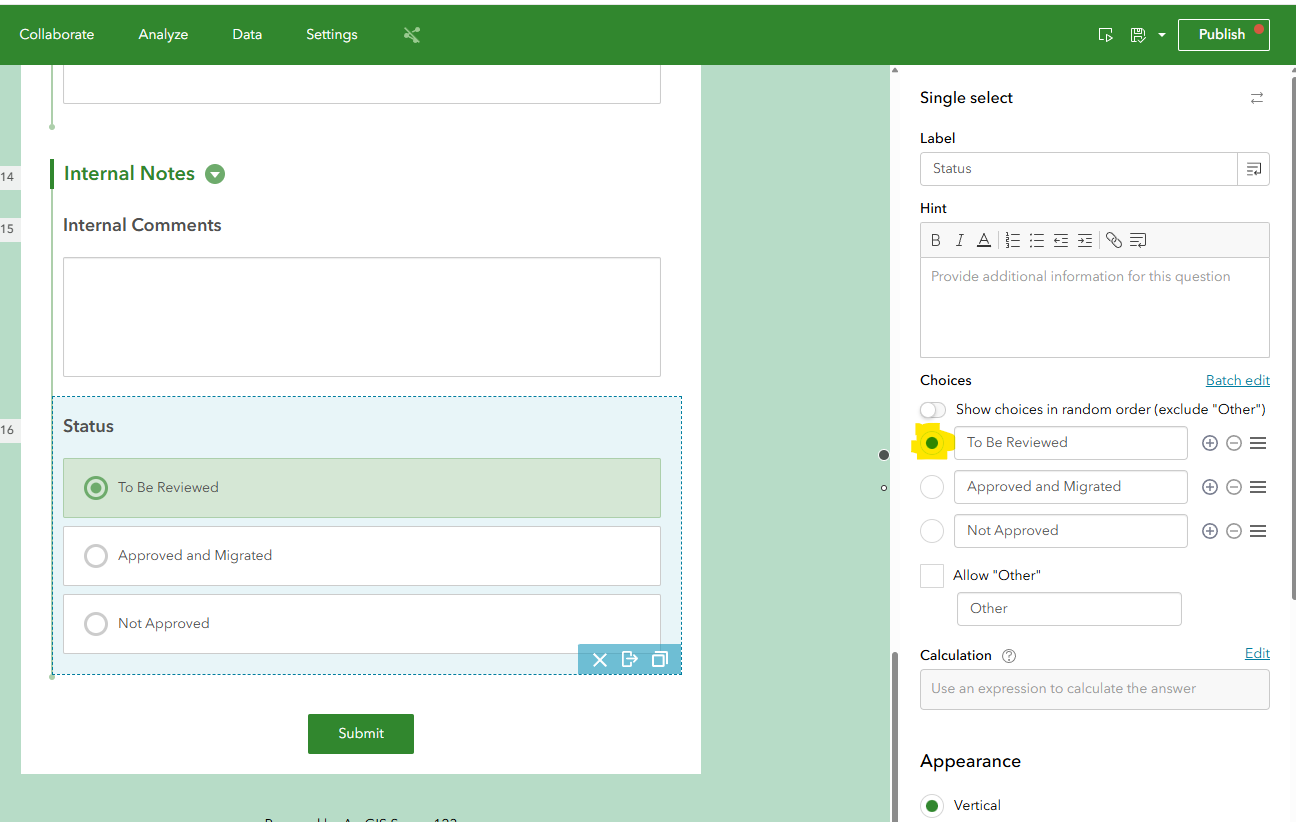

ZenMasterZeke
Works for me...
Created a blank survey in web designer at S123. Survey published to AGOL, not Enterprise.
