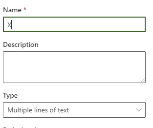

I am trying to get data from Survey123 form (including point location data and photos) to load into a SharePoint 365 list for co-mingling with data entered directly into SharePoint. I have successfully implemented a flow in Power Automate that inserts data in the list, including Lat/Long coordinates, but can't figure out if there is a way to link to the photos in survey123 for each entry. Is there a way to grab a link to photos from the survey to send to SharePoint as well?
Secondarily, trying to use List Map feature to visualize data SharePoint List. I followed directions here:
https://www.esri.com/arcgis-blog/products/esri-maps-sharepoint/analytics/arcgis-for-sharepoint-list-...

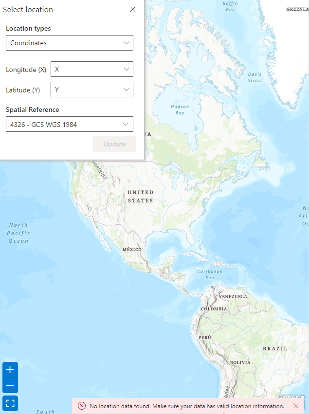

I have used this list map function on other lists and it has worked, but for some reason this time it only produces the error: "No location data found. Make sure your data has valid location information”. Any thoughts on troubleshooting why these coordinates fields are not being recognized as valid location information?
