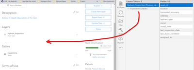

Hi @ZacharySutherby ,
This is the problem! They do not match. The schema on the survey is different from the layer on the survey, because I changed the name. How can I adjust the schema to match? Thank you!
ZacharySutherby
Hello @bsklaohfl
I would suggest making the change in the surveys XLSForm, if the issue is the main layer doesn't match you can set it in the form_id column of the settings worksheet. If the issue is a related layer or table doesn't match you will need to update the name of the begin repeat in the survey worksheet. Assuming you are using a submission_url Survey123 shouldn't let you republish the survey unless the schema matches.
