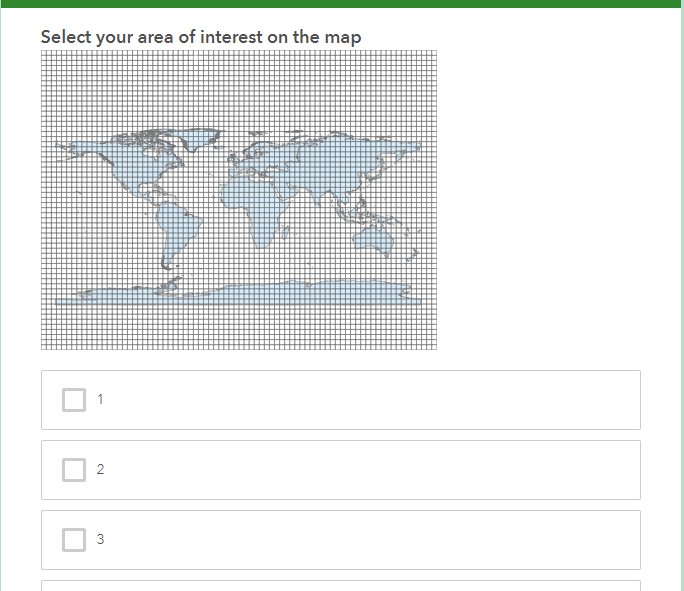

The image-map appears in the desktop version of Survey123 and I am able to click and select multiple cells. But, in my published survey in the web browser, the svg appears as an image that is not clickable, with the choices in a list below. I don't know what I am doing wrong.

When I publish and access the survey through the web browser, the svg appears as a non clickable image with choices below:
