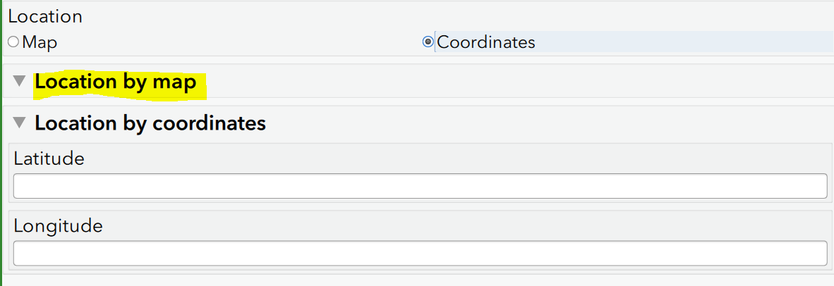

I am having a problem show/hide groups using 'select_one'.  What I would like to do is
Select one question = 'map' or 'coordinates'
If 'map'
----> show LocaionByMap group
else if 'coordinates'
---> hide LocationByMap and show LocationByCoordinates group
The problem is when 'coordinates' is selected, the 'LocationByMap' group is still there, though disabled clicking event.  What I would like to do is not showing 'Location by map' when 'coordinates' is selected.  How can I do this?  Please find an attached Excel for this problem.  I would very much appreciate your help!

Hi Makiko,
You've placed the relevancy statement on the geopoint question - it should be placed on the group.

Hi James,
 I didn't catch that.  Thank you so much!!
