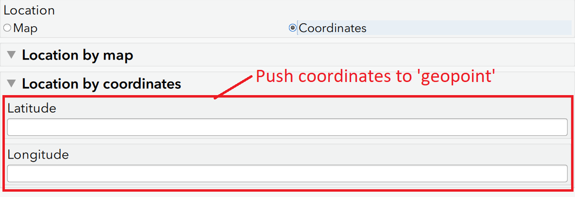

The Survey123 Web application provides user to place the location by map or coordinates.  Is there a way to provide the same functionality in the Survey for ArcGIS?  Is it possible to push (write) the coordinates input to 'geopoint' object so that typed location is mapped?
Survey123 Web application:
Is it possible to mimic above Survey123 Web application in Survey123 for ArcGIS?

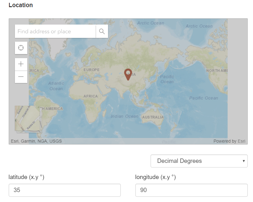

Survey123 already features the ability to input coordinates - you can click on the coordinates in the map to manually set them:
Aside from that, you can use the decimal boxes for latitude and longitude netter and then calculate the location - you would need to change the values in to a string of "<latitude> <longitude>".
