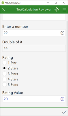

In the Demo I first fill out the survey and submit it. Then I go to the second survey, to the Inbox, refresh where I see the survey I just submitted, then Edit. I can see the value I entered for the number, but the select_one question is blank.

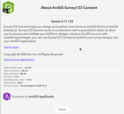

What version of Survey123 Connect and field app are you using?

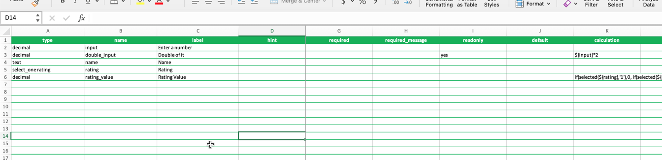

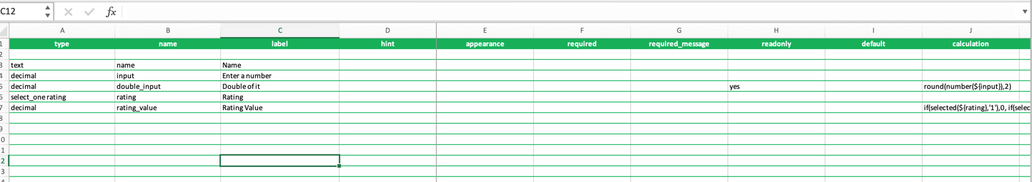

Are you able to share your xlsxform file (xlsx file from survey folder) so we can take a closer look?

Here are the versions:
The rating question has name set to 1,2,3,4,5 and label to 1 star, 2 stars... It is the default question
I am attaching the two spreadsheets below.  Thanks!

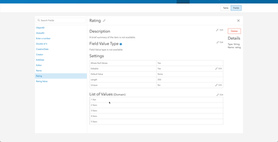

In ArcGIS Online if you navigate to the Item Details page for the hosted feature service your surveys are pointing to > select the Data tab > Fields > select the Rating field > Does that field have a list of domain values?

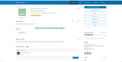

Thanks, but, I am new to arcgis. I managed to find the "hosted feature" that corresponds to the TestCalculation survey in arcgis, but, I can't find the page you show above. I don't know where to click to get to the "Item Details page". This is as far as I got:

Ok, I found it. It does have a list of values:
