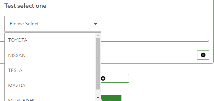

Hi, I am trying to set up a select_one_from_file but it isnt showing up as it should.
XLSform field setup, appearance = autocomplete. The field is inside a repeat.
CSV choice list, which is in the media folder
And on my Survey123 Connect (editor app), the field label shows up, but the select one list dropdown doesn't show the arrow button for dropdown.
However, this field on the web form works perfectly.
I'm needing to ensure that the survey will function properly in the field app too, not just in the web form - how do I fix this issue? Is this a bug?
I've been having a similar issue with using select() for choice filters as well, where it doesn't work in the field app (same as above, dropdown button not showing up) but works in the web form.

Hi Jim,
Thanks for your reply! Turns out my Survey123 connect app is not up to date, even though the xlsforms show version 3.12! Double checking a published test survey it seems it works fine on the latest version of the field app.. I just need to request an update to my Connect with my organisation. Thanks again!
