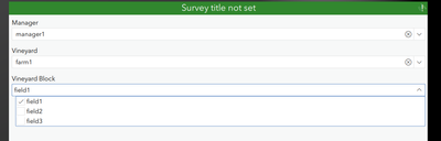

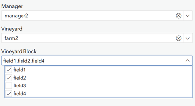

I recreated your survey, and I don't see the problem.
From the above, I have this for the survey:
Plus 3 CSVs:
In my test, it seemed to work as expected:
Is this what you see? If not, what do you see and what do you want to see?
EDIT: I attached all the documents.

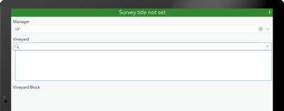

brandondurr
so its odd. your screen shot is what i expect to see. when i download your attached files, everything works (this wasn't the case using files i attached).
The initial data i provided was generic. If i update the labels and filter on column in each of your files (and mine), using my company's actual farm data the filters stop working.
