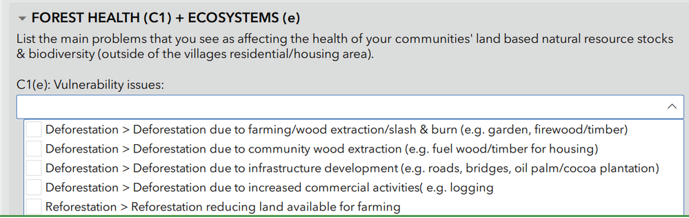

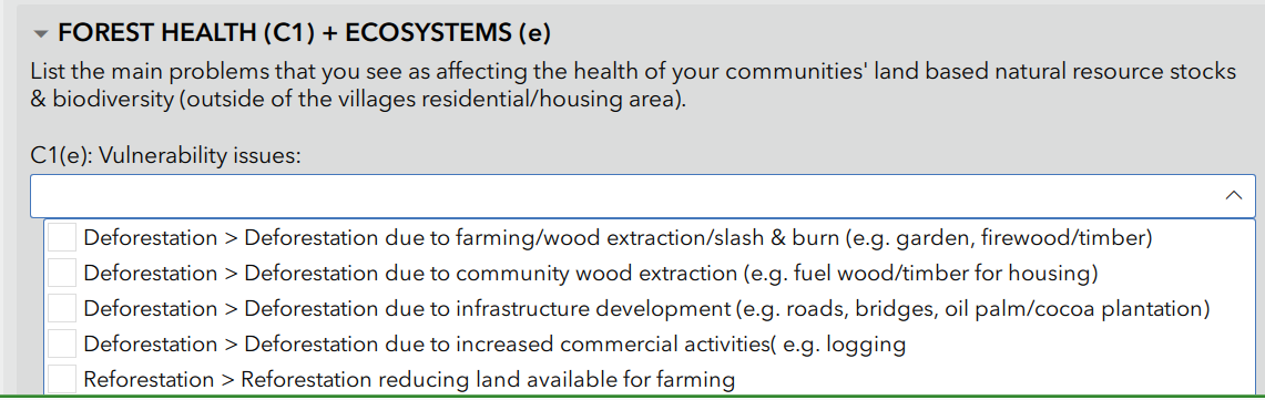

Hello,
I'm working on a survey questionnaire template on ArcGIS Survey 123 connect.
I had a query on 'Select_Multiple_from_file file_name.csv' Type question.
I want my survey form to ONLY display issues related to the 'asset' Forest Health + Ecosystem from more than a 100 choices.
Here's my question in the Survey 123 connect.
So I want the list in the drop-down to only contains issues related to the asset, Forest Health + Ecosystem.

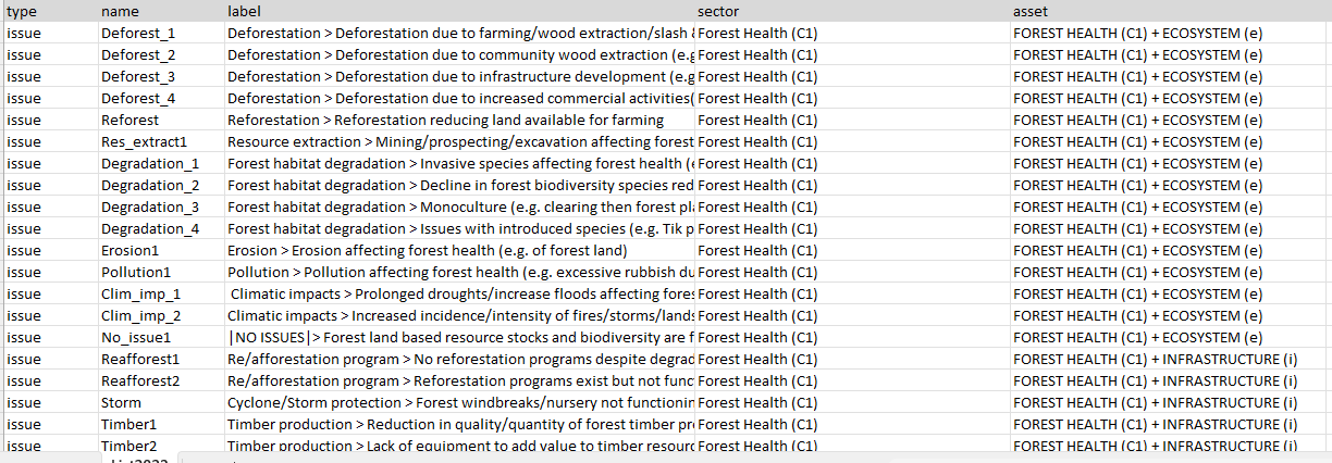

Here's my external Choice List>
I Would appreciate your help on this question.
ChristopherCounsell
MVP Frequent Contributor
Select_Multiple_from_file file_one.csv
Select_Multiple_from_file file_two.csv
You can have two CSVs and call upon them separately.

Take a look at the search() appearance which is kinda new.
https://community.esri.com/t5/arcgis-survey123-blog/dynamic-choice-lists-using-search-appearance/ba-...
I forget if choice filter works with select multiple or not.
Hope that helps
