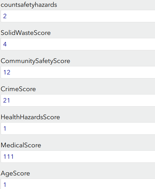

I'm trying to develop an assessment, but I'm not the brightest bulb of the bunch. The way I have it written, it lists the score values I've tried to assign instead of adding them together (e.g., instead of adding 3 "1"s together, it lists them as "111" instead of "3"). Any help is appreciated.

It does this since all fields are treated like strings inside the form so it is doing a concat.  In the bind::type column set it to int then the fields will act as int inside the form.  I thought integer in type worked fine now also but I guess not.

Thanks for your help. I've tried updated the bind column to int, but now the score is showing as blank instead of showing any values.

@DougBrowningis correct. This is definitely a case of text fields being used for math.
Here is a visual idea of that he is describing. Note the use of the bind::type column:
Which results in my_field2 properly adding my_field (e.g., 32+5+7=44) rather than combining fields (e.g., 32+5+7=3257) like you are seeing:
(note that this example is a very sub-optimal set-up for the purposes of an example. Typically, you wouldn't use a "text" field like this)

I've tried update the bind type to int, but now the score is showing blank instead of showing any values.

Thank you SO much for your help. You're a life saver. I got it working with your help, although for some calculations I had to add in an int specification in the calculation.
