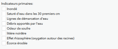

Hi, I am building a form in Survey123 Connect with multiple groups and pages so I am using the settings style "pages theme-grid".   Except, as soon as I use the theme-grid, all my select_one and select_multiple questions switch to "horizontal" appearance, going from this:

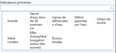

to this:
I have tried using the appearance "compact-1" thinking it might restrict the number of column to 1 but it did not work.
Could you help me go back to the "vertical" appearance for my select questions, while still using the them-grid style?

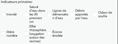

ÉmilieBerthiaume
Hi, Thanks for the suggestion but it did not work on the select_multiple questions.  they are now under a "drop-down" menu but still appears horizontal:
I think I will have to get rid of the "theme-grid" style...
