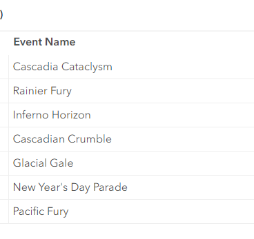

I am trying to pull in records from one feature layer to another with the user being able to select from a list of events created in the original survey.
Survey 1 - Want to pull in answers from event/Event Name

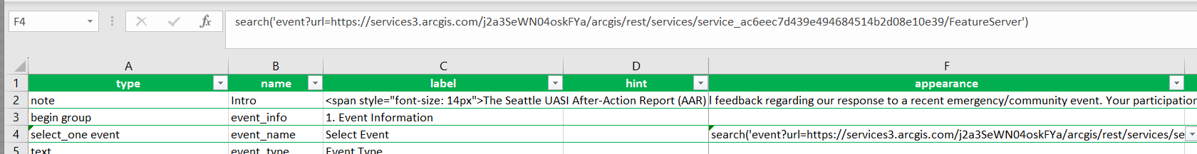

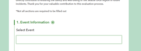

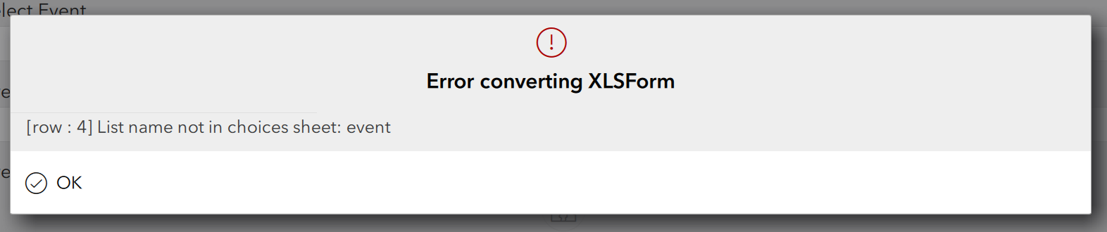

Survey 2 using search feature
dwold_2-1710525120032.pngdwold_2-1710525120032.pngdwold_3-1710525146416.pngdwold_3-1710525146416.png
Would like this to be a drop-down with Event Name list

I think you need to add the number of the layer after the FeatureServer part of your URL so it knows which layer you want.  For example FeatureServer/0
See this post for more info   https://community.esri.com/t5/arcgis-survey123-blog/dynamic-choice-lists-using-search-appearance/ba-...
