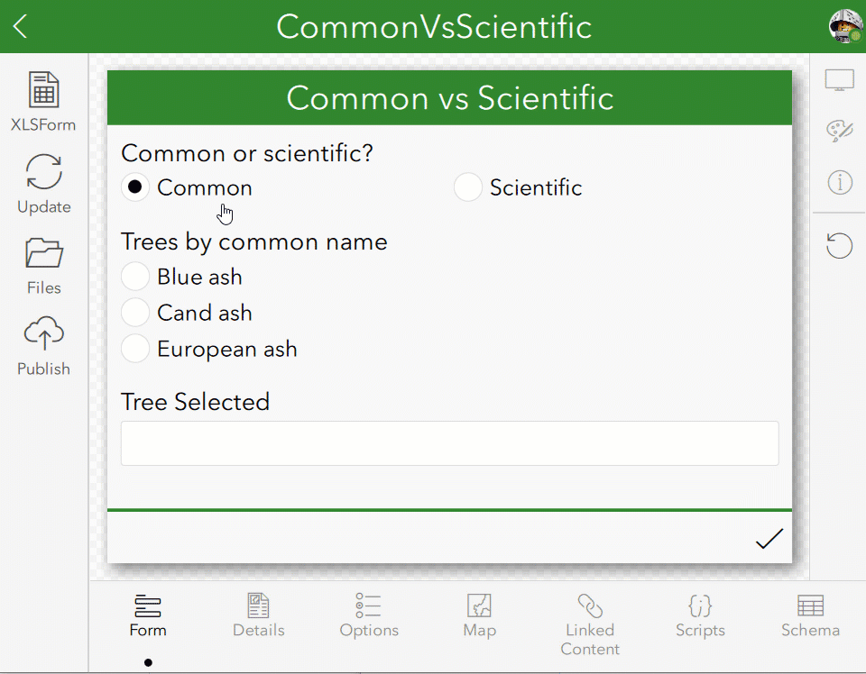

Hi. Do you want something like this?
If so, here is the XLSForm.
Some tips:
  • You may want to set the esriFieldType column to null for the common and scientific lists questions.
  • You also may want to set the appearance on the tree_selected question to hidden
  • If you want to work with a very long list of species, it is strongly recommended you use the select_one_from_file question type as described in the external choice list section of this help topic: https://doc.arcgis.com/en/survey123/desktop/create-surveys/xlsformessentials.htm

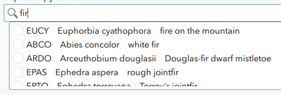

What I did is have the label be PlantCode [spaces] ScientificName [spaces] Common name.  Then set the name to just the plant code.
That way a user can search on anything they may know all in one box.  For example they know it is a fir but forget the exact just type in fir.
Works great.  Hope that helps.
