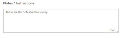

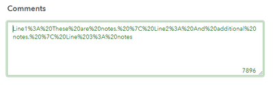

Now the same function encodeURIComponent(this.comments) when passing the data to the S123 textbox displays as:
I am not sure when this behaviour changed as I have not looked at this specific survey for a while. Is there a workaround to get the linefeeds back into the displayed text?
If the multiline textbox is updated and the data is saved into the underlying feature service and the survey is re-opened in edit mode using globalid as a parameter, the lines are displayed correctly across multiple lines
If you do not use encodeURIComponent then only the first line of the question value appears. This is similar to the behaviour we have noticed with:
Web survey opened from link with field settings using encodeURIComponent
https://survey123.arcgis.com/share/xxxxitemidxxxxx?portalUrl=https://domain.com/portal&open=web&fiel...These%20are%20the%20notes%20for%20this%20survey.There%20is%20more%20than%20one%20line%20of%20text&field:jobid=469&field:moduleid=1&field:location=8793%20Plein%20Street
In this scenario the text is cut off after line 1, but we do not see the html encoding characters

this.callComments = "Line1: These are notes.\nLine2: And additional notes.\nLine 3: notes";
//*** 1 **** this returns the textbox containing the full character set from the URL request
survey123WebForm.setQuestionValue({
             call_comments: encodeURIComponent(this.callComments),
//*** 2**** this cuts the incoming text after Line 1
             call_comments: this.callComments,
*** 1 ****
console.log(this.callComments);
*** 2 ****
console.log(encodeURIComponent(this.callComments));

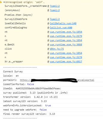

These warning are also displayed in the log - do we need to change the way the Survey123Form is called and/or update to js api 4.21?

Can you try version lock as a workaround?
To complete version lock, two settings needed to be done:
1, Set for web app version lock. Go to website --click on the specific survey--settings--web app versions: use the version the survey was published with;
2, Set for js api version lock.  When referencing js api,  be specific about version as https://survey123.arcgis.com/api/jsapi/3.xx
Try if this would serve as your workaround.

The version lock is for the multiline textbox issue, please have a try.
alison_gou
Hi @Dawn
We have an undergoing issue to support line break both in js api and url parameters.
The version lock is workaround for line break in js api.
Regards,
