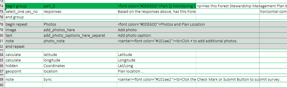

When I have Survey123 generate a report template for my survey, it has multiple fails and does not return photos.
The start tag ${# Photos} is unclosed.
Error: An error occurred when checking the report template. Failed to parse ${add_photo_captions_here_separat} since add_photo_captions_here_separat cannot be found in the current parsing scope.
How can these fail when this is the report template ESRI created?  I also tried to use Eddy Clark's solution from September:
Add this to the end of your doc.
${#$attachment}
${$file | size:350:0}
${/$attachment}
I get an error message and a return that states, "Failed to parse ${$file | size:350:0} since $file cannot be found in the current parsing scope."
I just want to create a simple report to extract photos from my surveys, but do not know a better way to do it.FSP Implementation Monitoring connect.png
