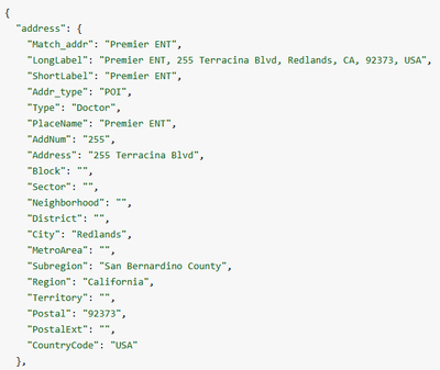

Is there any chance this is an option now?  I'd like to extract just the address (house number + street name) from the geocode result in the same way one can extract the city, state and so on.  I've tried the Address property shown here by way of pulldata("@json",${reversegeocode_json_output},"address.Address") but that didn't work.  The Reverse Geocode sample in Survey123 Connect is what I used as a basis for that.
AdamGebhart
@IsmaelChivite
Sorry, I did a little more digging and didn't come across anything that indicated the house number and street name have separate fields in the json.  The house number does have its own, so that's good.
The first image shows page 2 of the Geocode and Reverse Geocode sample in Connect.
