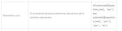

JavierCMartínezPrieto
Good,
if you use conditional expressions, the value becomes boolean.
greetings
url:https://doc.arcgis.com/es/survey123/desktop/create-surveys/xlsformformulas.htm
