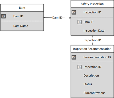

For clarity here are some details about the envisaged data model. The ERD will be something like this:
And a data example would look like this:
So I actually want to duplicate recommendations that carry over to the next inspection. In the example above Recommendation 1A is duplicated as 2A for Inspection 2 because it is incomplete. The reason for this is that a report of each inspection must be submitted to another system and so the previous and current recommendations need to be permanent for each inspection.
