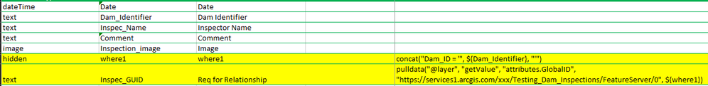

Using pulldata("@layer") works well to solve this issue, however I still think this could use some finessing from the Survey123 team to make this work without pulldata...
Some cleaning up needed, but as a proof of concept, this supports Workflow A above, which is what I was hoping for as I need to support reinspection of assets with extremely long inspection forms.

I actually thought of pulldata last Friday and plan on trying it this week. I think that will work and might be the best option for grabbing the proper GlobalID and writing it to my "dam_guid" field to solidify the relationship.
