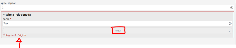

I noticed this same problem in version 3.17. However, testing again on 3.18, it seems to have been resolved, as shown in the image below:
Maybe re-publishing the survey in the new version of Connect (3.18) will also solve your problem.
MelindaLamb
I republished with 3.18 and still the problem persists.  If the user does not arrow over to the repeated records created, the required limitation is not enforced.  If the user does open the next record ,then they are required to fill in the question.  My users are skipping the additional records in the repeat and not opening them.
