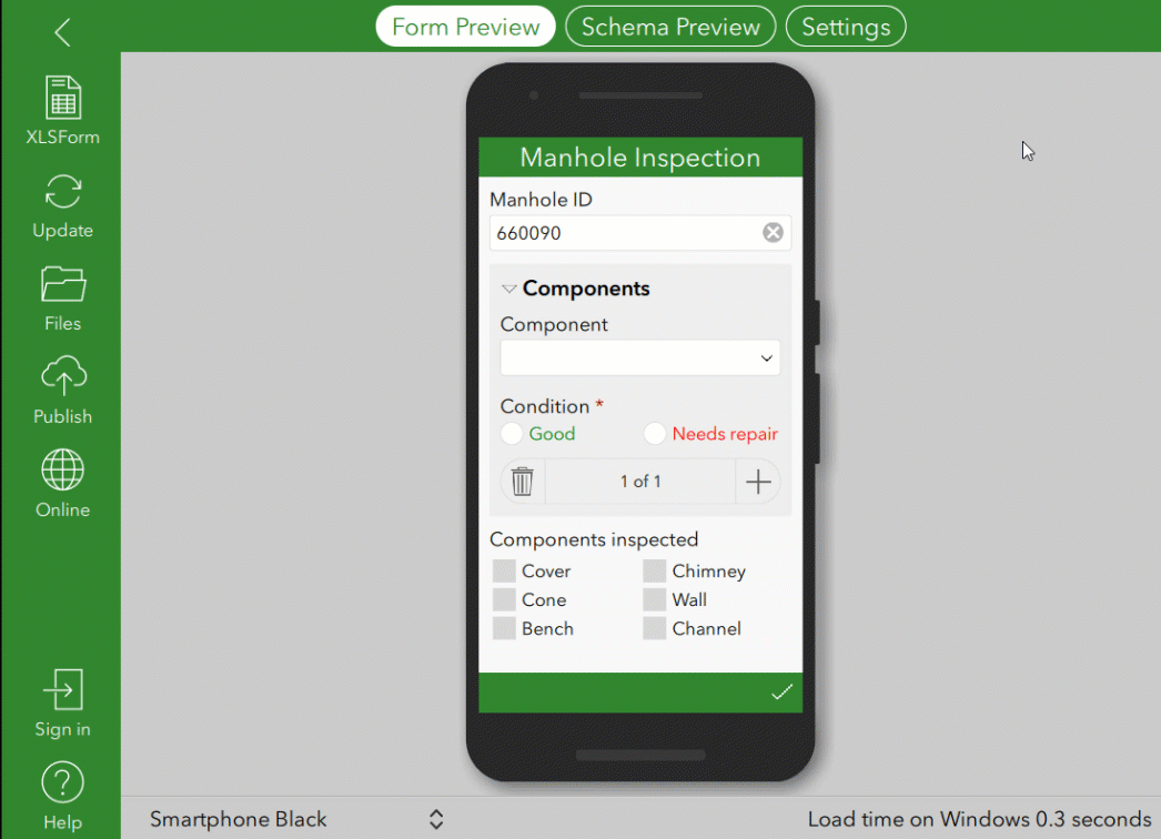

Using a join like this on the image above would probably make it work but I don't know how to implement this.
