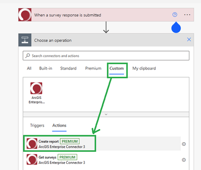

As for how, I can give you a quick guide for Enterprise/Power Automate:
  1. Make a new Custom Connector (The images are a little out of date, but the guide is fine)
  2. Make a new flow with your new custom connector
  3. Add a Create Report step to your flow
  4. The Power Automate steps guide you through the rest
And its that easy! Really, creating the Custom Connector is the hardest part in Power Automate now, and the guide does a good job of walking you through the steps.
