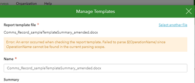

elpinguino
I'm almost there, but was wondering if someone who understands code a bit more could point out what I'm doing wrong here. I've attached my template. This is the error I'm getting.

elpinguino
Thanks Deon. I am using a related table, so that could work for me. Could you show me how I'd write that out though to capture the operation name and date? I'm not so good with code. I have the template attached in the original post.
