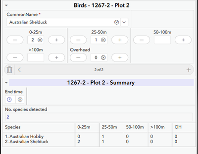

Hi Leigh - I have just trudged through many a post to find a solution to this - do you still need help? Let me know if you can provide screenshots and we can see if my solution fits your use case.
I've got my tally coming out as a summary at bottom like this - so we can see what we have entered on each repeat as we do our bird surveys.
