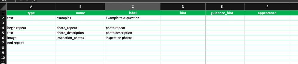

In addition, assuming your XLSForm is like below,
Can you please try something below, put the start and end tags out of the table, that makes each photo a separate 2-row table rather than 2 rows inside a single table to see if this helps avoid the issue?

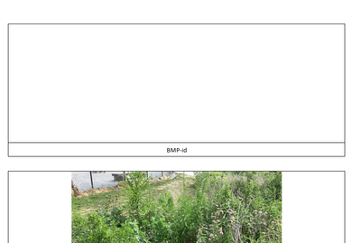

Hello @ZhifangWang , I finally had time to test this edit to the report template, and unfortunately it did not solve the problem. The first photo of the repeat question in the survey is still omitted from the report word document. However, as you can see from the screenshot below, the photo description is still pulling in as expected. When I click inside the table cell, it is empty. No placeholder white textbox/image or anything like that.
I have confirmed that the photo DOES pull in when generating a PDF directly, rather than a word document. (see screenshot below, it worked in both my original and modified templates). However, this is not a possible solution for us as these reports need to be reviewed and possibly edited, along with the fact that generating directly as PDF messes with the table formatting of the report.
Here is a snapshot from my XLS form, the photo section is set up almost identical as you have it in your screenshot. The only difference being that my image question is listed before the description question. I also have some notes fields that are used to help with UI and enforce image orientation in the survey (landscape).

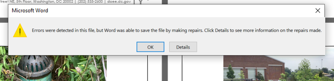

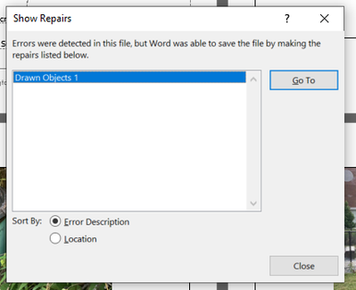

Another piece of information; when I manually copy/paste the photo into the report and then save, I get this message in Word.
Clicking "Details" produces this dialogue box. Clicking "Go To" then jumps to/highlights the newly pasted image.
