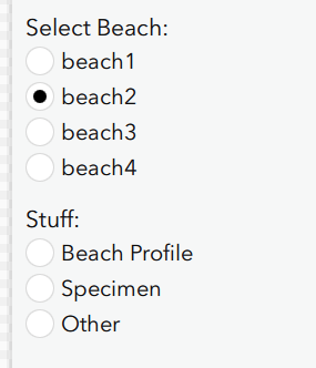

I have a list of 63 beaches. Thirty-six (36) of the beaches do not have streams. Twenty-seven (27) of the beaches have streams. The user must first choose a beach. If the user choses a beach with a stream, the next question will show four options (Beach Profile, Specimen, Stream Status, Other). If the user chooses a beach without a stream, I'd like the next question to only show three of these options (Beach Profile, Specimen, Other).
It seems that the logical answer is to use a Choice Filter, but for the life of me, I’m unable to configure the XLSForm properly. I’ve attached my XLSForm. Any help on this would be greatly appreciated. I'm stuck!

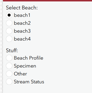

Try this:
And the related CSV:
The result is:
or

GFA_Nonprofit
Thank you very much! Fantastic!
