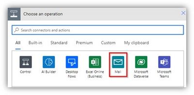

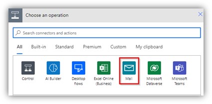

One thing I did notice is that this Esri workflow uses a different email operation than what I use. When I do an email action, I use this:

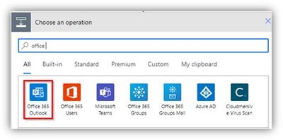

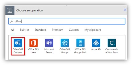

But on that website, they use this:
I’m wondering if the Office 365 Outlook operation that is in the Esri documentation is somehow “better” than what I’m using?
