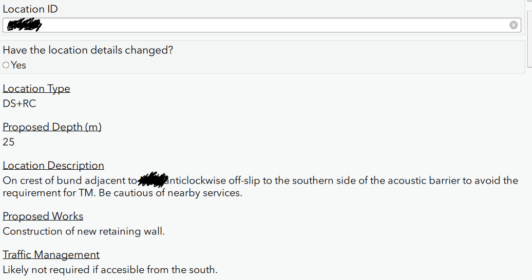

I'm currently pulling data through from a csv attached to my survey based on a Location ID field. However if that data changes on site, I have added in a select multiple so the user can chose to change one of those details.

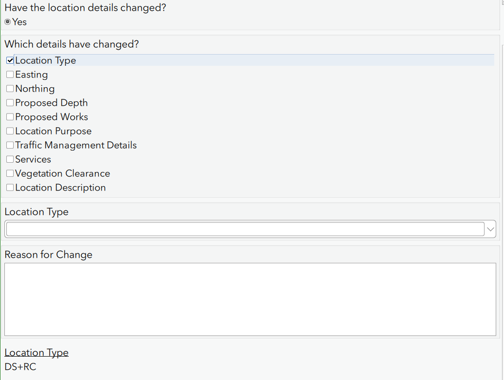

My issue is that I want the data draw through to be hidden should the user select the relevant box, such as in the images below where Location Type is ticked (I would want Location Type data draw through to disappear).
I have tried using the selected operator in various forms, but that only presents the field in case of a true return. I'm wondering whether it can test for an "unselected" feature, such as notselected(${LocationDetails}, 'Location_Type') so that the field only appears when Location Type is selected. I would link it to a master question (such as "Have the location details changed?" but that knocks out other functionality.

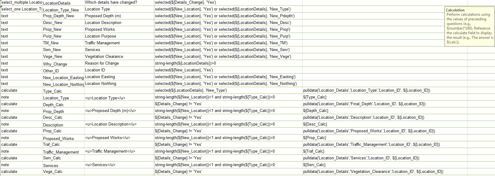

Hi Thomas,
One way to do this would be to compare the result to false():
selected(${LocationDetails}, 'Location_Type') = false()

ThomasPerriment1
Hi James,
Thanks for the quick response! I didn't know you could compare to false, thanks for showing me how. All working as desired now.
