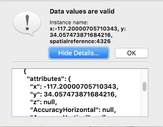

As indicated at Geopoints—Survey123 for ArcGIS | ArcGIS, the function to get the horizontal accuracy is pulldata('@geopoint', ${location}, 'horizontalAccuracy') .  When a point is manually set, this value becomes null:
The appropriate relevancy calculation is
pulldata('@geopoint', ${location}, 'horizontalAccuracy') != null
