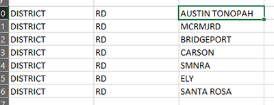

Thanks for the reply. The Allotment question is successfully hidden by the ${RANGER_DISTRICT} ='AUSTIN TONOPAH' expression, however when AUSTIN TONOPAH is selected in the DISTRICT question, the ALLOTMENT question does not appear like I want. I attached my XLSForm below. I appreciate any help.

Ok, thanks for sharing! That cleared things up. The equivalency expressions refer to the 'name' of the choices worksheet, not the label.
In your form, all the choices for DISTRICT have the same name. Change the names to be the same as what's in the label column and the relevant statement should work.

Amazing, that you for catching that, it fixed it perfectly!
