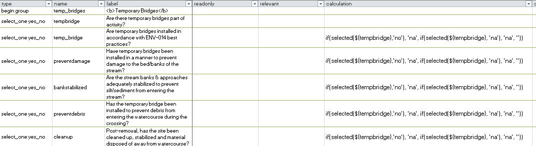

I have been struggling to find a solution to my problem so I am reaching out to the Survey123 community!
Here is what I want to happen:
If a temporary bridge is not needed for a project I want the user to select NO or NA and move to the next question, "hiding" the follow up questions relating to temporary bridges and calculating them to NA .
I have only been able to do one or the or the other; only show relevant fields or calculate fields to NA if the users selects NO or NA (see image below)
So, if the user selects YES to temp bridge they will see the follow up questions and answer accordingly and if the user selects NO to temp bridge they do not see the follow up questions and those questions are auto populated with NA.
Can anyone help me figure this out!
Thanks
JamesTedrick
Esri Esteemed Contributor
Hi Rhonda,
By definition, making a question not relevant, no data will be submitted for a question.  Is the fact that response is null sufficient to know that the question is not applicable in your workflow?  If not, I would calculate the field and also set to read-only (which can take the inverse function of the relevant statement).
