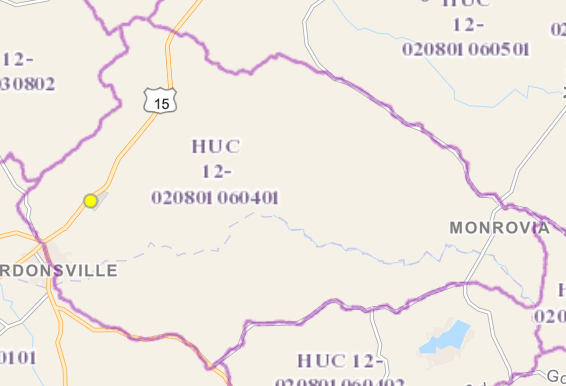

Hi,
I am creating a survey to assist with environmental regulatory compliance for my client. I would like for survey users to be able to select their location and have the Hydrologic Unit Code (HUC) associated with that area autofill. For example, for the yellow point in the area shown below I want to have 020801060401 automatically fill in a separate field.
I know that I can reference the X,Y points from the Geopoint type using the pulldata() function (using pulldata("@geopoint", ${location}, "x"). Is it possible to then intersect that point with another feature service and put the HUC value into my survey?
Thanks in advance.
