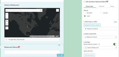

Thanks for the suggestions @DougBrowning and @clt_cabq ! I was exploring a bit on Survey123 Web some more and almost thought I found a web-only solution.
In a field Calculation, it looks like you should be able to reference a layer in AGOL (from survey A) and choose a field to auto-populate the text in Survey B when you snap a point to the same location on a map question.
This calculation sample I have comes from the text field restaurant name, but appears that it should be able to grab the chosen field from the point layer and calculate it into the text field when the point on the map snaps to the points from Survey A.
However, this doesn't actually seem to populate anything. Have either of you tried something like this or worked with calculations in web designer? I want to keep Survey A and B (in terms of data) separate, but just have the ability to call names from submission A into B.
