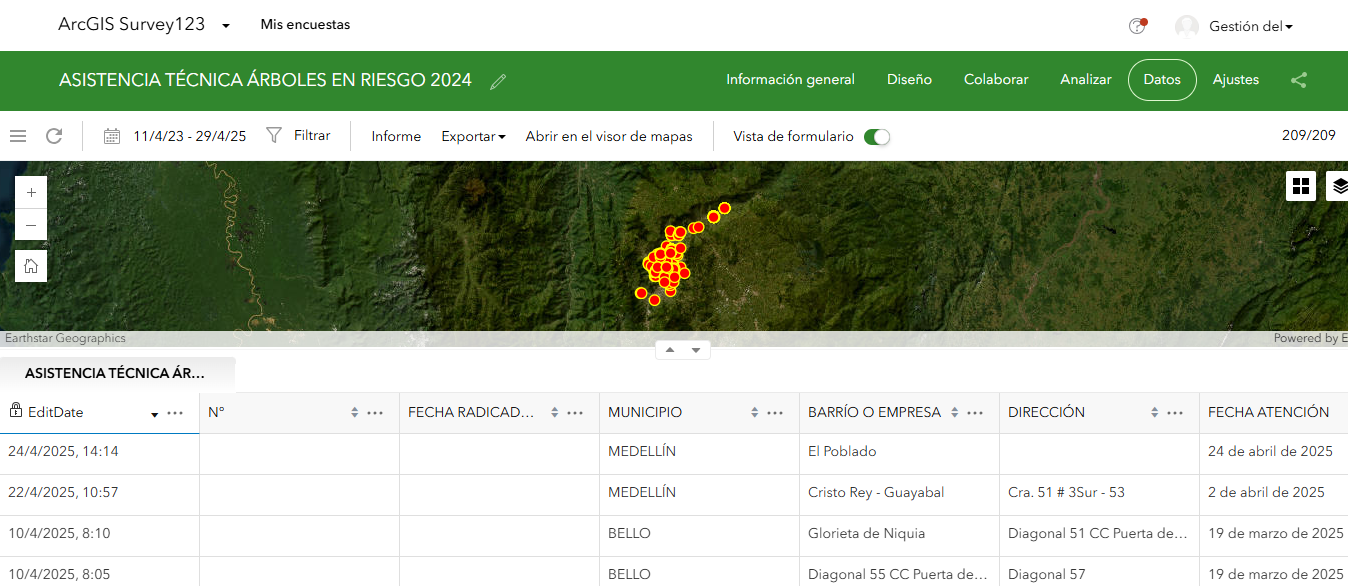

Hi, I have a form in Survey123 that already contains many records. I want to update the form by adding two new questions, but when I do that, all existing records are deleted.
I’d like to create a new form that includes all the questions from the original version, along with the two new ones. However, I’d like to know if there’s a way to transfer the records from the previous form to the new one so I can view all the submitted information in the Survey123 web interface.
The idea I have in mind is that in the new form I can visualize the records that were made in the previous one.
