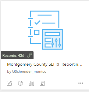

Greetings,
Recently I had a problem with a published survey123 connect form. This survey is accessible by two accounts in my organization. The data in the feature service was deleted when the form was updated incorrectly but one of the accounts that can access the survey shows the data in the feature service still. I am assuming the reason I can see the old data on one account is because it was not the account used in survey123 connect desktop editor when the data was deleted. My question is if it is possible to reconnect the old layer which I can still see under one account (figure 1) with the live form (figure 2) that has been still receiving data and was appended to include the old data*.

Hi. Using Survey123 Connect, you can make a survey target a feature layer of your choice. Check out this help topic: https://doc.arcgis.com/en/survey123/desktop/create-surveys/survey123withexistingfeatureservices.htm specifically, the Author a survey that matches a feature layer section describing how to use the submission_url and form_id XLSForm settings.
