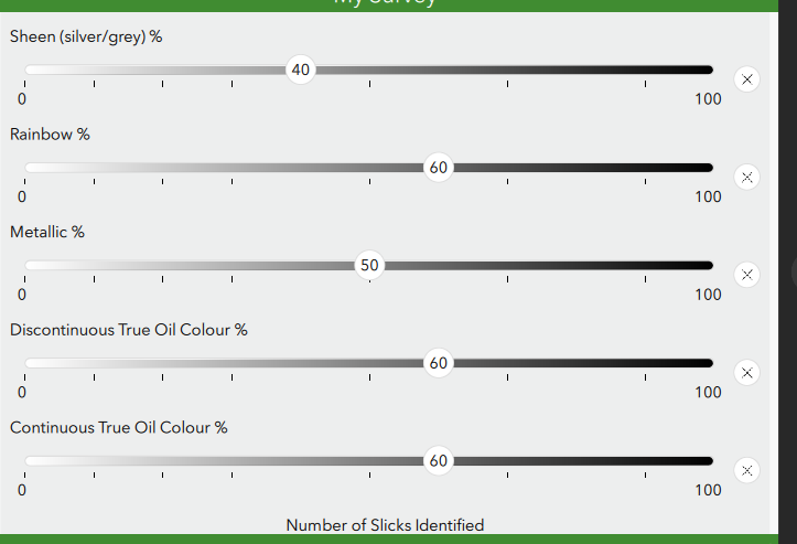

Is it possible to make all of the range types add up to 100%? So you cant have 100% sheen and Rainbow but could have 20% of all?

Apologies for the delay. You can have a constraint on one or more of the questions (though not all, as that might cause a calculation loop) to check to see that the total across the 5 questions adds up to 100%.  It would be something like:
${sheen} + ${rainbow} + ${metallic} + ${discount_color} + ${cont_color} = 100
The specifics might differ slightly depending on the exact name of the questions.
