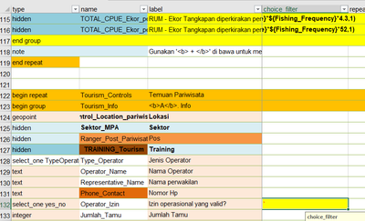

Appologies but I'm suddenly experiencing a similar issues. The XLS form worked like a brease before but I must have inserted a mistake somewhere but I'm absolutely unable to find it.  I was also unable to decifer (nor copy and paste) the error message given by Survey123.
If you have a tool to test or find out more about the error, Would you accept to have a look at this rather complicated Xlsform?
Thanks
Ruth_JiatengXu
Hi @Arnaud_Brival
Thanks for sharing here, and I am sorry for the late response.
It seems like there is an extra "`" in the choice_filter column for your Operator_lzin question, see the screenshot below:
I have attached the XLSForm with the extra "`" removed, and this should work with no issue.
Thanks,
Ruth
Arnaud_Brival
Thanks a lot @Ruth_JiatengXu ,  It really took me a while to find this cryptic typo! Thanks!
